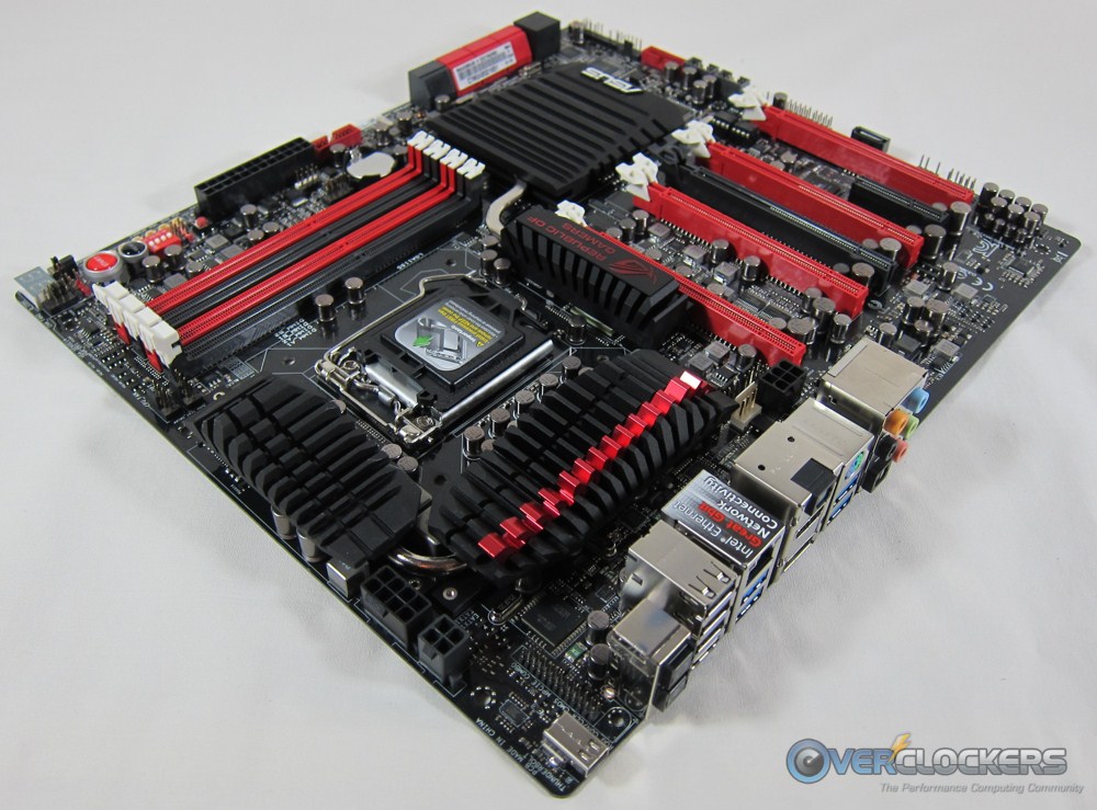

ASUS’ packaging has been similar throughout recent Republic of Gamers releases, with a red theme complete with a window into your system’s future. They have a clear plastic topped box for the board and a regular cardboard box for the accessories.

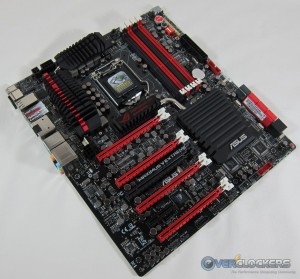

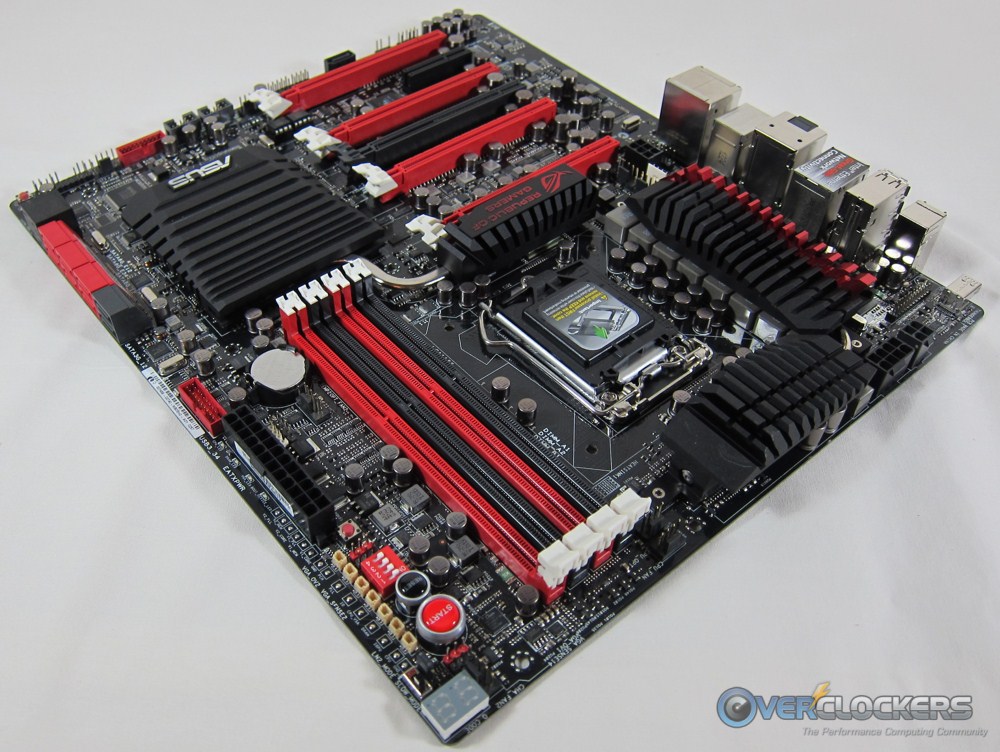

Pulling the board itself out for its photo shoot, we are met with a beautiful example of a Z77 ASUS ROG Extreme motherboard. The Maximus V Extreme’s (also known as “MVE”) heatsinks look great and the ROG red & black color scheme is back and as good looking as ever.
One last gratuitous photo and we’ll be done here.

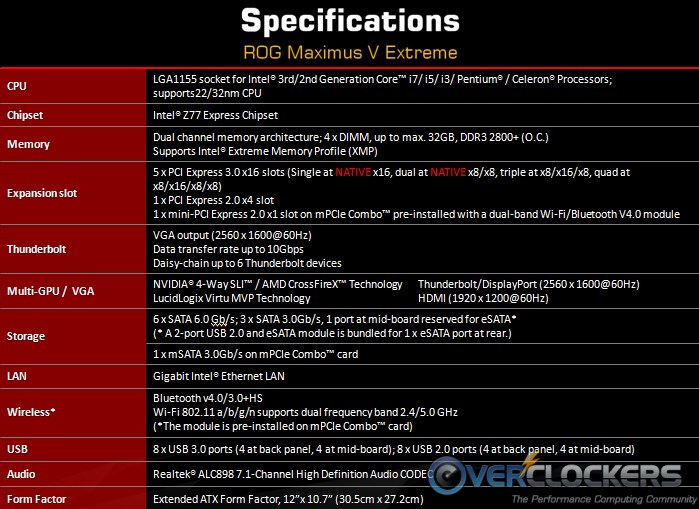

Specifications & Features
The Maximus V Extreme comes chock full of features – frankly, so much so it’s going to make this review seem quite long! They’ve outlined many of them in a handy-dandy image.
For the full list of specifications, we’ll direct you to ASUS’ Maximus V Extreme page, which has the extremely long list in its entirety. Starting off the features list, it’s great to see that OC Key has made the transition from ultra-high-end Rampage IV Extreme to the high-end-of-the-mainstream Maximus V Extreme. You may remember this from our review of the RIVE. We’ll go over it here too of course.

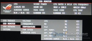

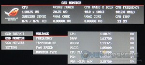

OSD Monitor

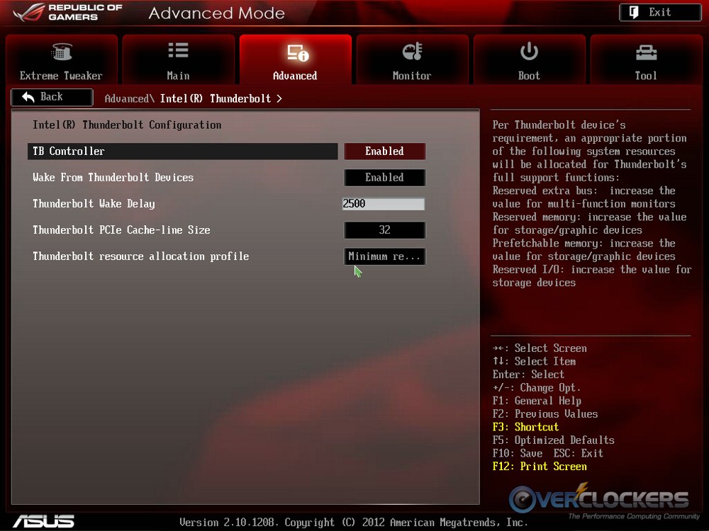

New to the market with later versions of Z77 motherboards is Intel’s Thunderbolt interface. We don’t have any Thunderbolt devices to test, but its inclusion is nice for those that need high-speed external devices. Impressively, you can even operate displays off of Thunderbolt.
Intel Thunderbolt

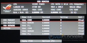

VGA Hotwire was outlined in our review of the ASUS HD 7970 DirectCU II TOP and is present only on ROG “Extreme” boards. For a board at this level, it’s a nice value-add.
VGA Hotwire

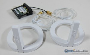

This is new to the Maximus V Extreme. The mPCIe Combo card was present with the Maximus V GENE, but unlike the GENE, with the Extreme they include the Wi-Fi/Bluetooth module.
mPCIe Combo + Dual-band Wi-Fi / Bluetooth 4.0

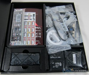

ASUS Extreme ROG motherboards come with what can only be seen as an extreme accessory stack. I mean, just look at the box; it’s practically overflowing with accessories. While you’re going to pay a pretty penny for an Extreme SKU, it does include an extreme number of features and value-adds.
In the “normal” accessory pile, you see a USB/eSATA bracket, enough SATA cables for all of your drives (six SATA III and two SATA II), the user manual, driver disc, handy labels for your cables, and the I/O backplate. Inside the driver disc pouch is a handy chart on PCIe configuration options.
Aside from the “normal” pile, you have quite a few non-standard motherboard accessories. Here we’re getting into Extreme territory. Like the Maximus V Formula, first up we have the mPCIe combo card. Frankly, I thought they would only include this on the GENE because it saves space for mATX builds. Not so. They included it with the big dogs and even added the dual band Wi-Fi & Bluetooth module as an additional value. This solves the problem of trying to add even more controllers onto the PCB: just make wireless features an option via an included card and call it a day! They also include two antennas that plug in as displayed and come out of the rear I/O backplate. In addition to the wireless capabilities, you can even add an mSATA drive to the other side of the controller card if that interests you.
When speaking with them about the MVE, ASUS pointed out was that the mPCIe card has a real purpose on this board. On the MVG, it is to help save space in SFF builds, but doesn’t come with the WiFi/Bluetooth module already installed. On the MVE, since it comes with the module, it is to keep you from taking up an expansion slot with a WiFi/Bluetooth card like competing motherboards. They’ve labeled and sold this as a 4-way CFX/SLI board and they say their board lets you use 4-way without compromising the wireless solution.

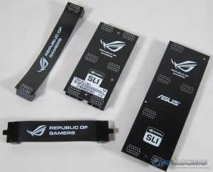

Next up in our more enthusiast-oriented accessories are the video card bridges. They only include one Crossfire bridge as most manufacturers are wont to do for some reason. However, because Tri- and Quad- SLI requires rigid bridges, they include all of those to custom-fit the motherboard.
Now we get to what I like to consider the ‘advanced overclocking’ accessories. In standard ROG fare, you have the ROG Connect USB cable for controlling this PC with another. Then you have the ROG ProbeIt connectors, which are stellar for extreme overclockers that need to monitor voltages with a multimeter. These allow you to plug your meter in and forget it, rather than hunting and probing individual measuring points every time. It’s a serious time saver, and seconds count when you’re benching with dry ice and liquid nitrogen.
The last advanced overclocking accessory is the OC Key. You saw a screenshot of what it’s capable of above. Originally included with the X79-based Rampage IV Extreme, it’s great to see this part make the port to the more mainstream Maximus offering.
There are more accessories than you can shake a stick at with this motherboard. A good accessory stack is nothing without the board it supports though, so let’s get to know the Maximus V Extreme better.

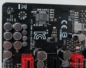

If you’re going for seriously upgraded onboard sound, the Maximus V Formula is more your style. The Maximus V Extreme has a Realtek audio codec that is sufficient for most people, but there is so little room on this PCB that they couldn’t go to the lengths they did with SupremeFX IV. This board is built for one thing – ultra high end performance, pushing your components to the max. If you want better sound, you’ll need a sound card.

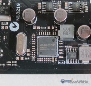

Continuing our tour you see the ASMedia USB 3.0 controller for that bottom header and the Nuvoton system monitoring chip.

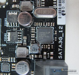

Then you have the SATA connections. Like the Maximus V Formula, the Extreme comes with the two native SATA 6 Gb/s connectors but ASUS has chosen to use only two of the native SATA II connectors from the Z77 PCH, exchanging the other two ports for two ASMedia controlled SATA 6 Gb/s connections. There are two more via a second ASMedia controller, for six SATA 6 Gb/s connections total.

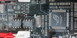

Here is a closer-up photo of the dual BIOS chips. They’re even removable, so if you REALLY nuke one, you can replace it no problem.

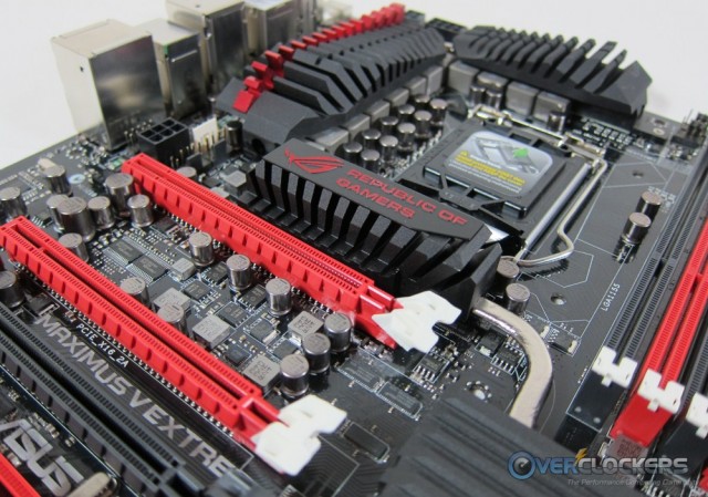

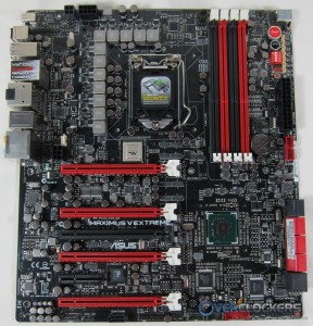

Take a minute to examine the bare PCB of the Maximus V Extreme. Just look at how chock-full of electronics this board is. It really is a sight. We talk about powerful motherboards and this has got to be one of the most power-full boards I’ve ever seen. I might be wrong on this, but based on the number of choke/MOSFET/capacitor combinations throughout this board, there are fully thirty one (that’s 31) power phases disbursed throughout this PCB. Obviously that’s not just for the CPU; its power uses the huge alloy chokes, but for the components as a whole, all told there are 31 phases. Crazy.

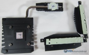

Here are the very nice looking, not to mention heavy, heatsinks themselves. There are two segments connected by heatpipes – the MOSEFET heatsinks and the PLX PCIe multiplier + Z77 PCH heatsinks. There is also a small MOSFET sink on the back of the board. All dissipate all the heat they need to and look great to boot.

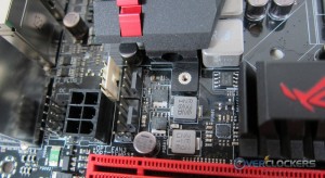

Last, but absolutely not least is the CPU power section, complete with eight strong DIGI+VRM phases for the CPU and four for the iGPU. These use ASUS’ well-known, upgraded alloy chokes, “Japan-made 10K Black Metallic capacitors” and upgraded MOSFETs. It’s plenty of power to push any Ivy Bridge CPU to the limit (or past it!). This is all controlled by the proprietary ASUS DIGI+VRM/EPU controller chip.

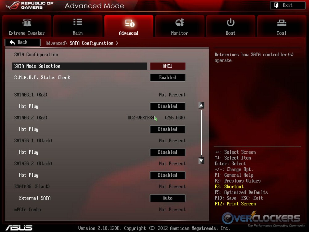

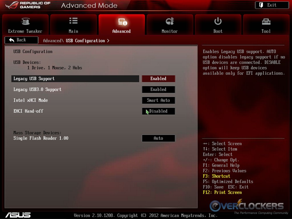

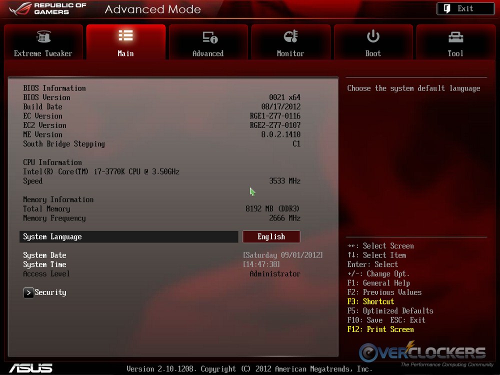

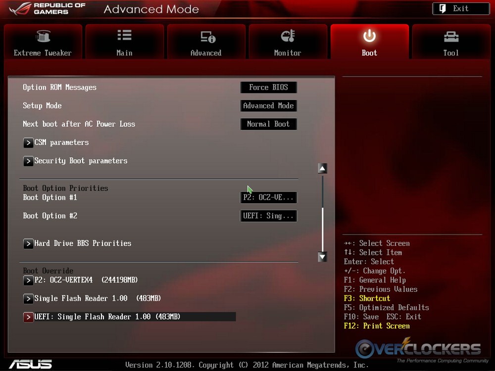

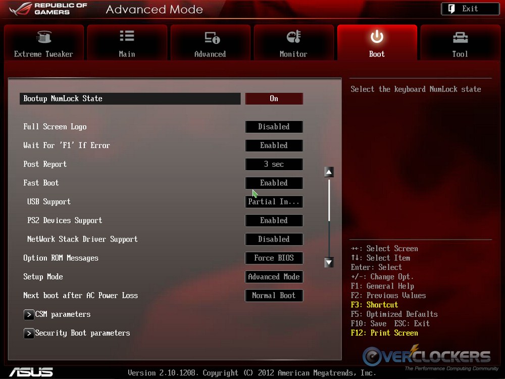

The UEFI

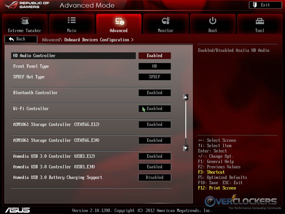

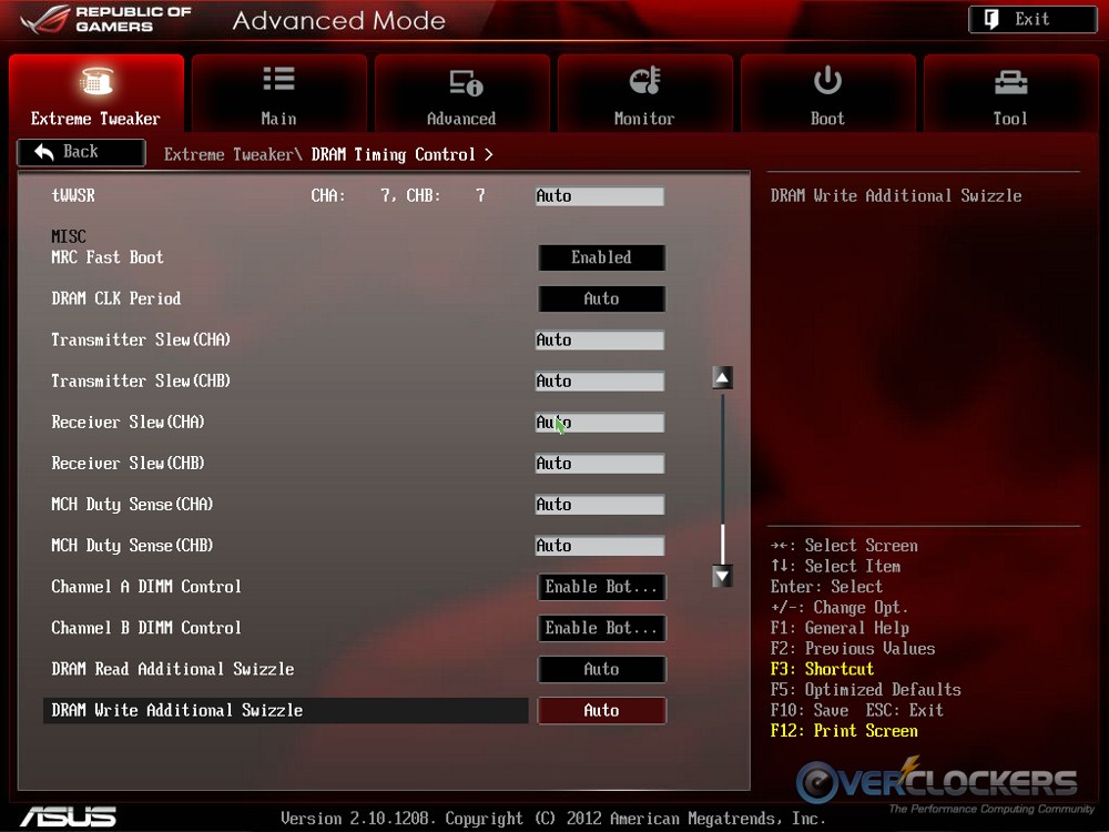

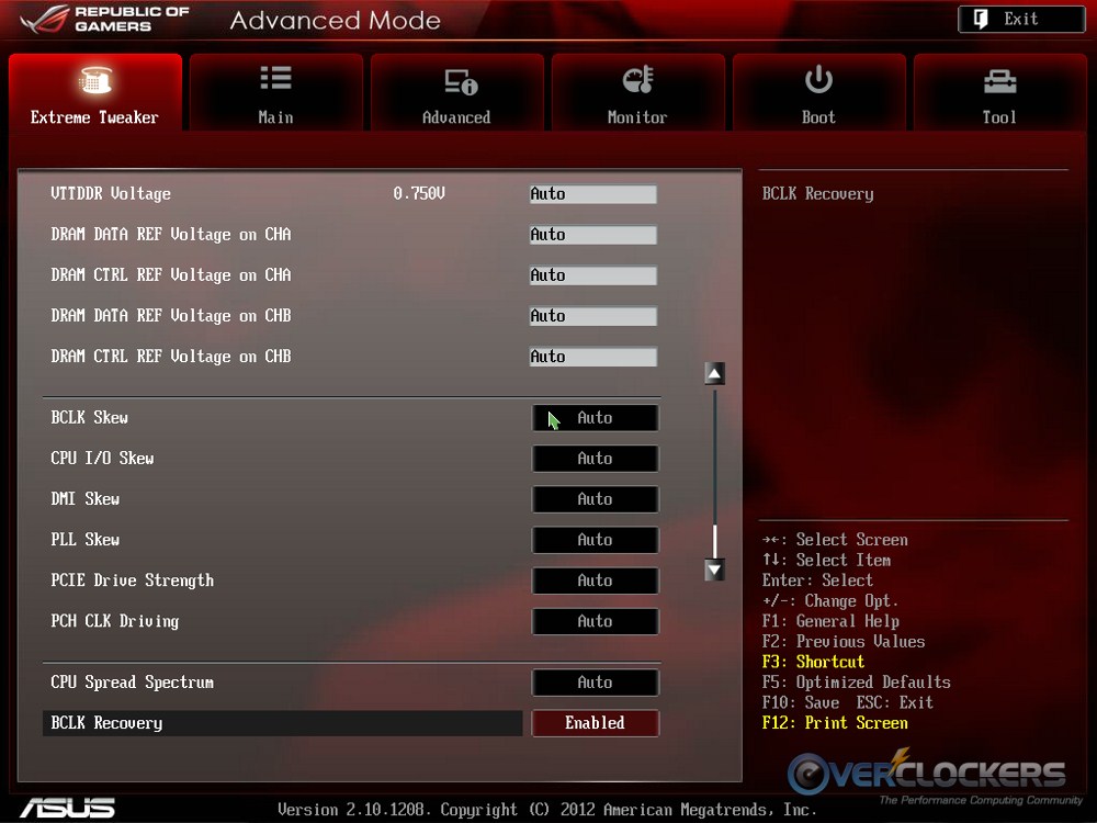

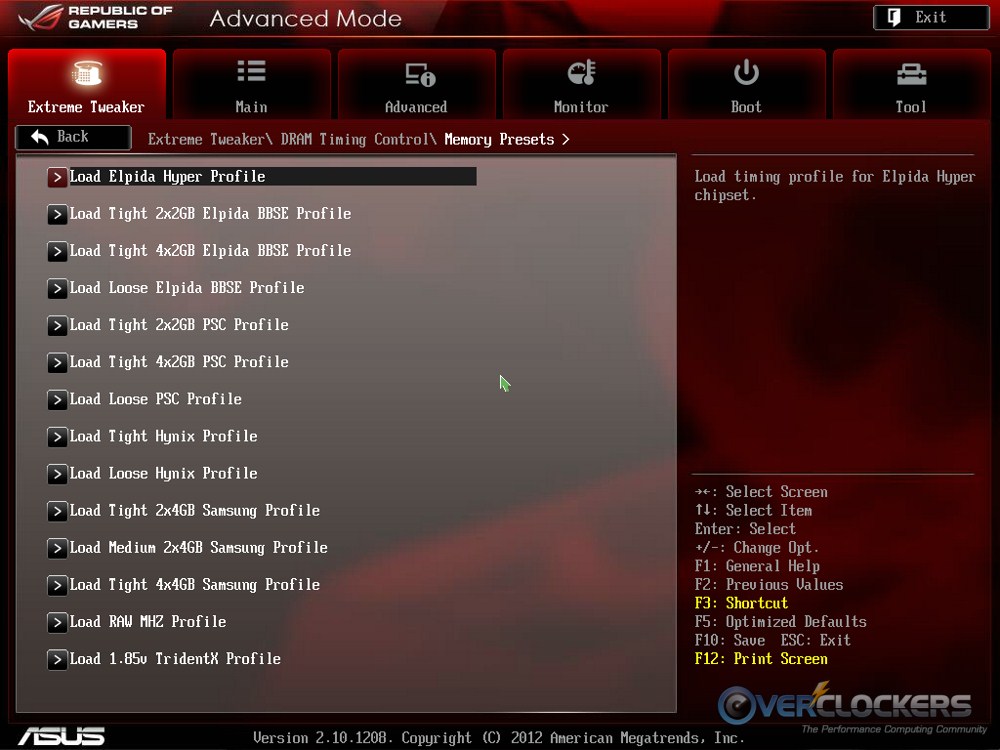

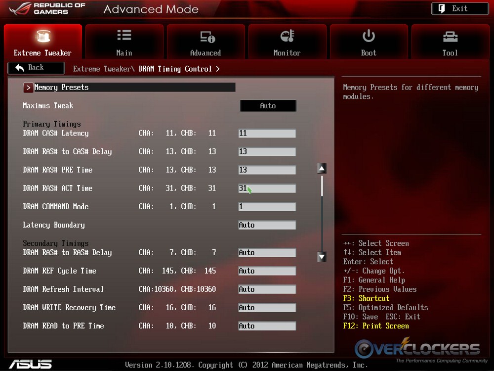

To explore the Maximus V Extreme UEFI, we’ll begin at the beginning. When you boot to BIOS on this board, you are dropped right into the Extreme Tweaker menu. Here you control every voltage, BCLK and multiplier setting you could need. Once you dig into the RAM sub-menus, tweaking ability gets even more detailed. There are more RAM settings and RAM profiles than any one person could ever need, but as a whole, they have at least something for everybody.

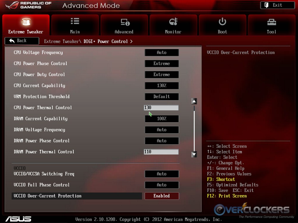

Moving into the other Extreme Tweaker sub-menus, there is GPU.DIMM Post to check your GPU & RAM at a glance. CPU Power management has a couple of options, but when you want real power management, just jump into the DIGI+ VRM menu. There you can control CPU, RAM & VCCIO power, with adjustments for LLC, VRM frequencies and more. In GPU Tweakers’ Paradise you can adjust voltages for the PCIe slots and PLX chip. Additionally, this is where you can adjust GPUs that are connected via GPU Hotwire.

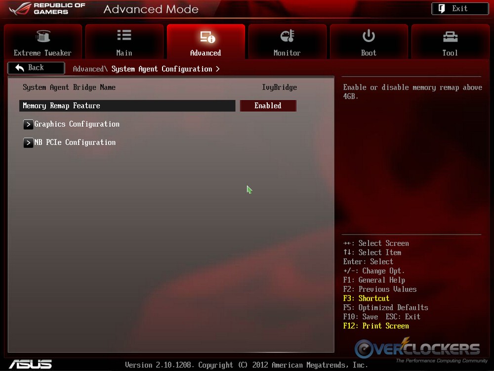

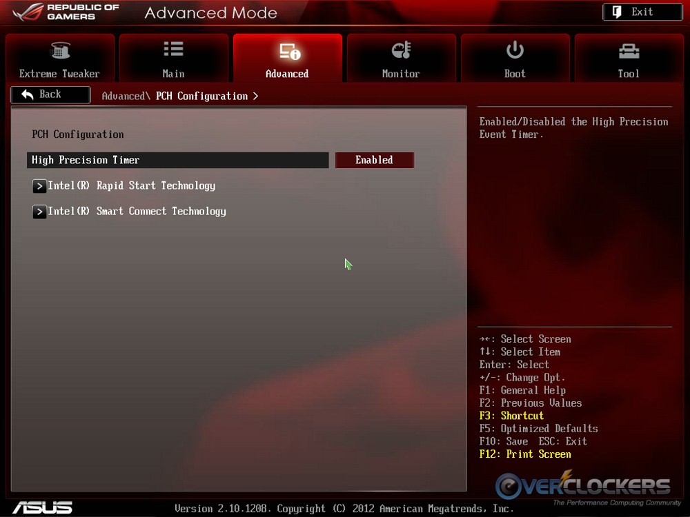

There are additional CPU configuration options within the Advanced menu. There are other more standard BIOS options here, screenshots for which you can check out below.

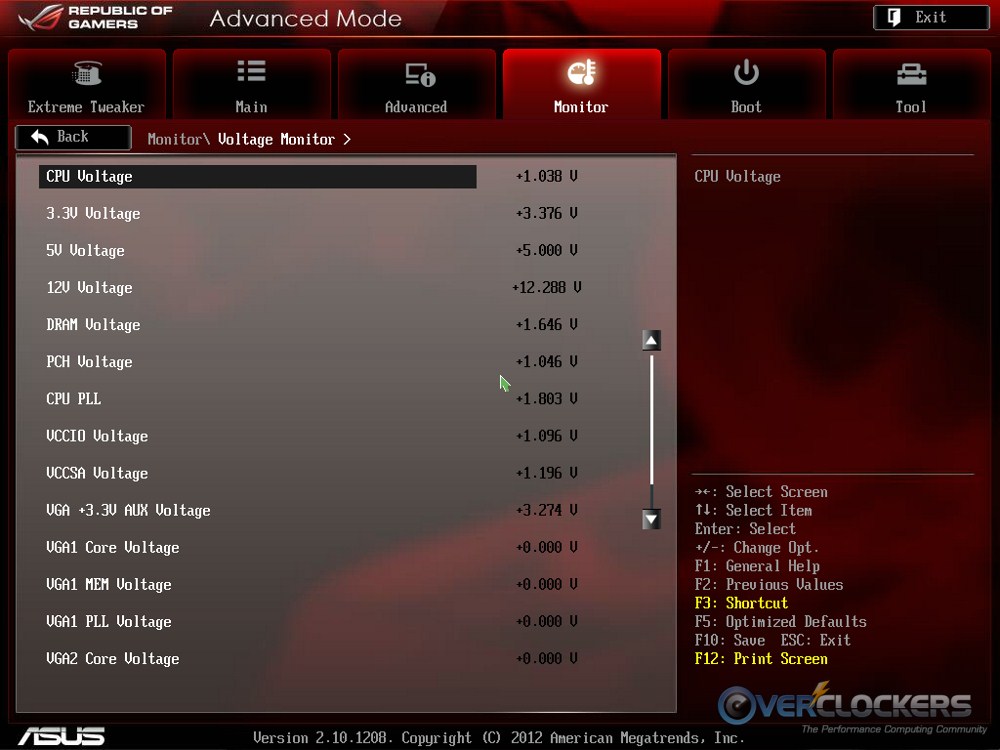

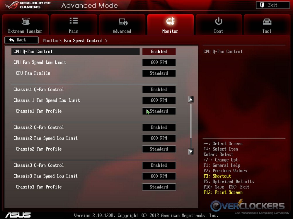

The Monitor menu is where you can both check the status of your system’s voltages, temperatures and fan speeds as well as set BIOS control over your fans. There are a lot of options in here, with control over fan headers for the CPU, the three Chassis fans and three OPT fans.

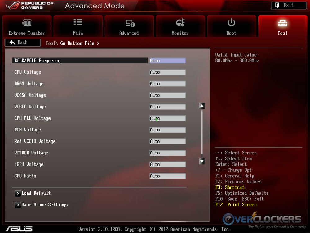

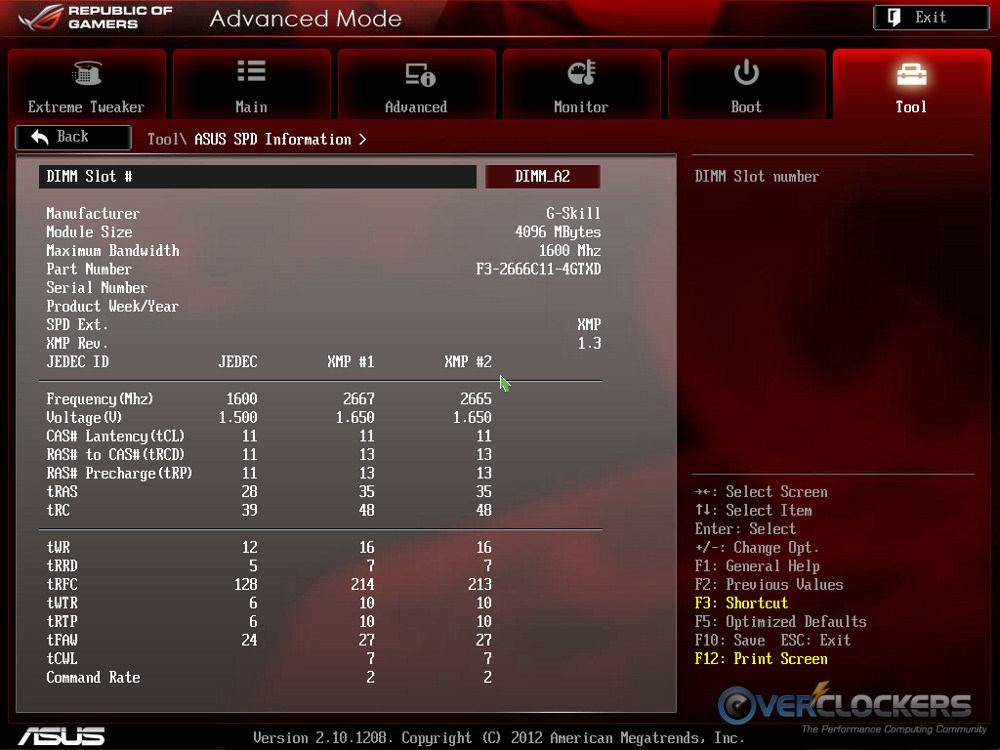

In the next series of screenshots we’ll detail is the Tool menu, which is close to being as important as Extreme Tweaker. It is here that you can store your OC Profiles, check your RAM’s SPD, set the GO Button profile and flash your BIOS.
The remaining BIOS screens are your standard fare, like device control, storage configuration, etc etc. They’re all below for your perusal.
One thing that’s transparent to the user but important to point out is that this UEFI, like all of ASUS’ Z77 (and all X79) boards, is in a CAP format. The biggest difference the end-user will notice is the drastically reduced boot time, letting you get into Windows much faster (it’s a very palpable difference). It also has extra security to prevent UEFI infection and some Windows 8-centric features.

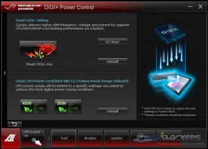

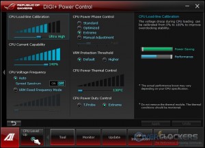

Thanks to the DIGI+VRM controller, you also have auto and fine-grained manual control of all things VRM. You can control both CPU and RAM VRM settings from in-OS. I’m fairly certain ASUS is alone in this respect, no one else has this kind of control via software.

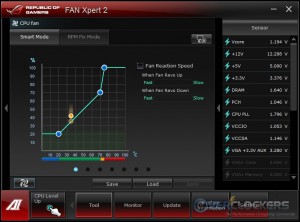

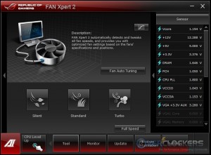

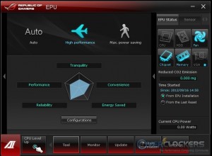

Fan Xpert 2 gives you auto or manual control over most of the fans attached to your motherboard.

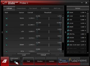

Probe II gives you handy pop-ups if your monitored voltages, temperatures or fan speeds go out of range. The range is completely customizable too, so if you intentionally set something (like Vcore) out of the range, you can simply adjust the range. It’s great for telling if you have a fan or pump go kaput, rather than having your CPU throttle due to heat. Sensor Recorder is great for those that enjoy monitoring their system. If there is a sensor, you can record it right here.

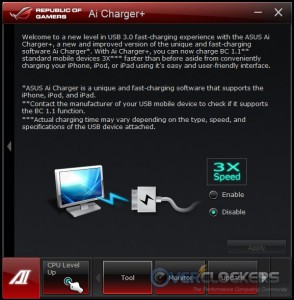

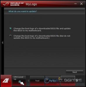

AiCharger+ is for those of you with iDevices, allowing faster charging via USB. USB 3.0 Boost uses a couple of methods, which I went over in a prior review but will pass on here to so you don’t have to find it on your own.
USB 3.0 Boost makes transferring via USB 3.0 faster via Turbo and UASP protocol. Turbo speeds up normal BOT protocol speeds by allowing a large package of commands to be sent rather than just one at a time. UASP allows parallel commands to be sent to the device. ASUS has some graphics explaining what USB 3.0 Boost does and its benefits if that interests you.
Last up are some of the more mundane AISuite features. You can update your BIOS from here, which I do not recommend – use EZ Flash II, it’s safer – and you can change the boot logo from BIOS. With ASUS’ CAP UEFIs, booting is so quick you’ll rarely catch a glimpse of the boot logo, but if you want to change what you see for a second or two, you can. Last in our series of screenshots is System Info (warning – wide image) and Settings, which are both pretty self-explanatory.
AISuite is a strong set of programs with a convenient base of operation in the AISuite toolbar. Nothing to complain about there. However, most of that is present on most ASUS boards, so what separates the Extreme? OC Key.

Lastly, you can even control the GPUs you’ve got hooked up through VGA Hotwire.

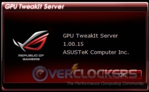

GPU TweakIt Server allows you to use ROG Connect to overclock your GPU as well.

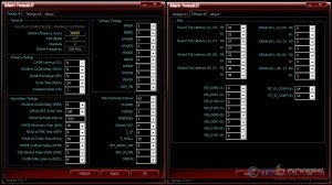

Mem TweakIt is -I think- the only software of its kind; at least I have yet to see it on other motherboards. It allows you to tweak almost all memory timings, right from inside the OS. This one has been around for a couple generations now and it is a great boon to memory tweakers out there.

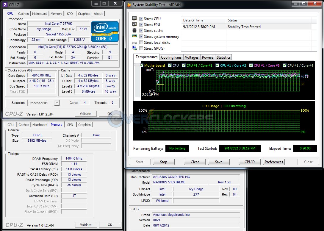

Overclocking for Stability
Overclocking an i7 3770K on the Maximus V Extreme was very much the same as it was on the Maximus V GENE. A board doesn’t make a 4.8 GHz Ivy Bridge CPU into a 5.0 GHz one – no board can, no matter who makes it. I tried – boy, did I try – to make 4.9 GHz, but the CPU just wouldn’t do it. Heat and voltages both just became too high for stability on ambient cooling. Thus, we’re still using the same 4.8 GHz overclock, complete with easy set-it-and-forget-it DDR3-2800 RAM speed.
Obtaining was a painless exercise pulled off with ease through the MVE’s great BIOS interface.

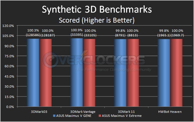

Benchmark Results
In benchmarks, I wouldn’t expect a ton of variation. The one thing to watch out for is graphics; we’ll get to that very shortly.
Rendering & Compression
First we’ll look at rendering, compression and video encoding. Strangly, both Cinebench tests saw the MVE lose a little bit off the GENE’s scores when the systems were overclocked, but not at stock. 7-zip showed a slight gain. PoV Ray & x264 both had a similar back and forth. As you can see, the stock results are basically identical. The overclocked discrepancy is a function of the overclocked results only being run once, where the stock runs are an average of three runs. There’s nothing to be concerned about here, the boards will perform very close to identically.
3D Benchmarking
The one thing to watch out for is graphics. I went through our entire GPU review suite using the ASUS HD 7970 DirectCU II to see if single-GPU performance was affected in any meaningful way with the PLX chip onboard.
Thankfully, that answer was no; the PLX chip does not have a meaningful impact on single-GPU performance. They went back and forth in both synthetic and game benchmarks, just like 2D benchmarks did. ASUS said they took the PLX chip out of the equation when you run a single GPU and now you have proof they did just that. Win or lose, there was one FPS or less difference in every game except Dirt 3, which runs such high FPS, it jumped all the way up to a whopping 1.3 FPS variation.
2D Benchmarking
When benching SuperPi and WPrime, the Maximus V Extreme showed slight gains in two of the benchmarks and slight losses in the other two. Again, the boards are identical when benching CPUs at the same speeds; if extended through, say, 10+ runs, I daresay they’d be within a couple tenths of a percent every time.
So, what did all those benchmarks teach us? The Maximus V Extreme and the Maximus V GENE will perform the same at the same frequencies throughout. Time and time again we see that motherboards are bought for their features and their build quality. No motherboard from anyone can take the same CPU & RAM and make it work miracles at identical frequencies.

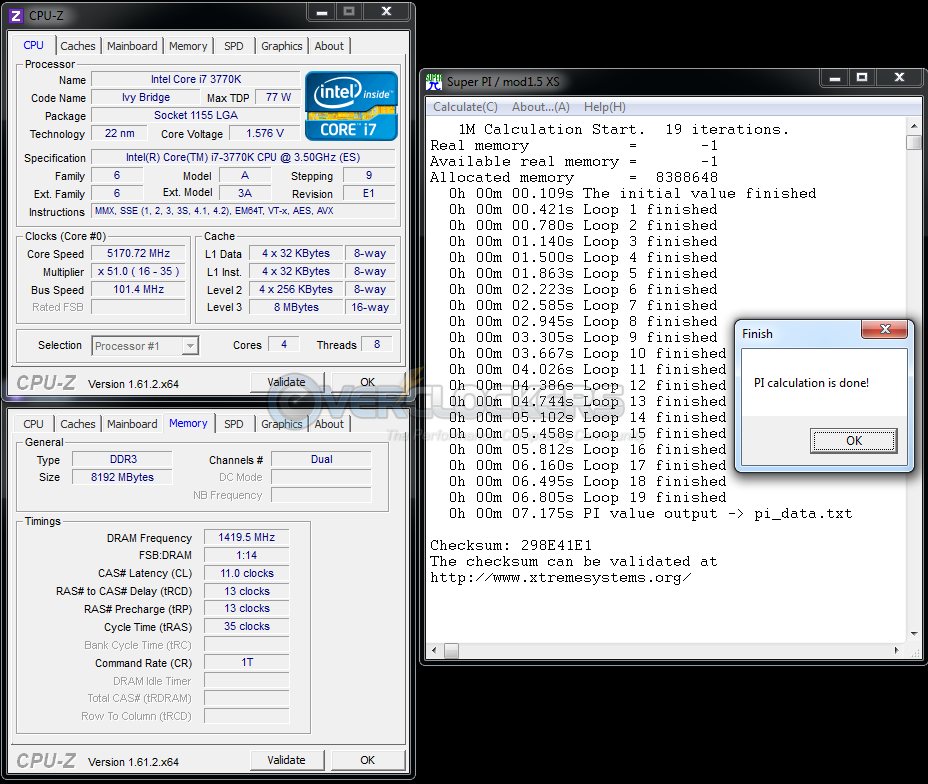

As with the 24/7 overclock, there is only so far you can push an Ivy Bridge CPU before temperatures rear their ugly head and get in the way. With Sandy Bridge, you could get very near (or even to) the max multiplier on water cooling. Not so with Ivy, so we’re stuck pushing as far as temperatures would let us. In this case, the board and CPU did ok for themselves, reaching just north of five GHz for running full-threaded WPrime.
Of course, stopping there is no fun. We were able to squeeze an extra 150 MHz plus for single-threaded benchmarks PiFast and SuperPi, topping out at 5170 MHz for SuperPi 1M.
Ambient Ivy benchmarking is tough, but once you get to know your CPU (and its limitations), it’s still fun seeing how many MHz you can squeeze out. This motherboard is made for cold and if time had allowed, I’d have taken it cold to show what can be done under those conditions. That will happen eventually, time just hasn’t been on my side recently. When it does, you can rest assured it will be livestreamed!
